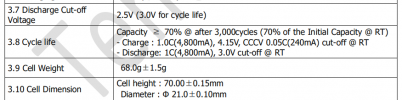

  • 48X is known as a specially upgraded version of 48G. It has a pretty long cycle life and performs better than 48G. But note that I only tested the 48X version 2 (=48X2), and I don't know the difference between version 1 and 2. A snapshot of the official document:48X.png
