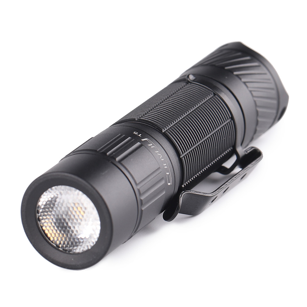

Moin. Die Anleitung zur Konfiguration der Taschenlampe lautet:
if flashlight is turned on,tap the switch 20 times quickly to enter into config mode.(On a visual interface,as long as you click on an option, it means that the option is selected. The flashlight has no visual interface. It flashes to represent an option, and "tap the switch in the flashing process" means to select the option.)
Option 1 (normal-flash 1 time + buzz-flash): tap the switch to enter into sub-option to select the mode group,If the user has no operation, the config mode will enter option 2.
-------------sub-option 1.1 (normal-flash 1 time) : tap the switch to select mode group 1 (1%、10%、30%、100%)
-------------sub-option 1.2 (normal-flash 2 times) : tap the switch to select mode group 2 (1% 10%、35%、100%、strobe、biking、batcheck)
-------------sub-option 1.3 (normal-flash 3 times) : tap the switch to select mode group 3 (100%、35%、10%、1%)
-------------sub-option 1.4 (normal-flash 4 times) : tap the switch to select mode group 4 (1% 20%、100%、strobe、biking、batcheck)
-------------sub-option 1.5 (normal-flash 5 times) : tap the switch to select mode group 5 (1%、20%、100%)
-------------sub-option 1.6 (normal-flash 6 times) : tap the switch to select mode group 6 (100%、20%、1%)
-------------sub-option 1.7 (normal-flash 7 times) : tap the switch to select mode group 7 (1% 10%、50%、strobe、biking、batcheck)
-------------sub-option 1.8 (normal-flash 8 times) : tap the switch to select mode group 8(1%、10%、50%)
-------------sub-option 1.9 (normal-flash 9 times) : tap the switch to select mode group 9 (50%、10%、1%)
-------------sub-option 1.10 (normal-flash 10 times) : tap the switch to select mode group 10 (20%、100%)
-------------sub-option 1.11 (normal-flash 11 times) : tap the switch to select mode group 11 (100%、20%、strobe)
-------------sub-option 1.12 (normal-flash 12 times) : tap the switch to select mode group 12(100%)
Option 2 (normal-flash 2 times + buzz-flash): tap the switch to active the mode memory or inactive it,If the user has no operation,flashlight will enter into the last mode.
Ich habe sie gerade nicht vor Ort zum Probieren.
Welche Option mit welcher Sub-Option ist bitte der Default?
Versehe ich es richtig, dass Sub-Option 1.12 nur aus dem 100% Modus besteht? Damit würde ein tiefes Drücken (also Anschalten) diesen Modus bewirken und ein halbes Drücken den Modus nicht ändern (weil es keinen weiteren gibt). Richtig?
"Option 2" verstehe ich noch nicht.

Option 1 müsste Default sein. Wenn das OK ist, musst du nichts ändern.
Option 12 besteht nur aus einer Leuchtstufe = volle Power. D.h. aber auch Batterie schnell leer.
Option 2 hat 4 Helligkeiten (1% 10%、35%、100%) + Strobe (Blitzlicht), biking (spezielles Blinkmuster fürs Fahrradfahren), batcheck (Batteriestandsanzeige - funktioniert aber nur mit Lithium Akku). Option 2 macht also am wenigsten Sinn.

ich versuch noch mal, die englische Anleitung auf deutsch zu formulieren ... :
Lampe einschalten ... dann mindestens 20 mal "quickly" tasten (halb drücken), dann wird die Lampe für einen Moment dunkel ...
jetzt ist man auf der ersten Konfigurationsebene ... hier gibt es zwei Wege : den Einstieg in das Gruppenauswahl-Menü oder das Aktivieren / Deaktivieren des Mode-Memory (also ob die Lampe beim Einschalten die zuletzt benutzte Leuchtstufe verwenden soll oder eben nicht ...)
zuerst bietet die Lampe Option 1 an, den Einstieg in's Gruppen-Auswahlmenü : "normal-flash 1 time + buzz-flash" ...
das bedeutet, nach dem kurzen Moment Dunkelheit blinkt die Lampe einmal auf und gleich danach so ein pulsierendes Blitzen / Blinken ...
währenddessen einmal tasten, damit ist man dann im Gruppenauswahl-Menü ...
und dann geht's auch schon sofort los und die Lampe bietet durch die entsprechende Anzahl von Aufblinken die jeweiligen Gruppen nacheinander an ...
"normal-flash 1 time" : Gruppe 1
wenn man die Lampe nach diesem einmaligen Aufblinken direkt ausschaltet (oder 1 x tastet), wählt man dadurch die Gruppe 1 ...
macht der User nichts, bietet die Lampe Gruppe 2 an : "normal-flash 2 times" ... (usw.)
wenn man also die 5. Gruppe haben möchte, dann direkt nach den 5 mal Blinken die Lampe ausschalten (oder 1 x tasten), damit ist diese Gruppe gewählt ...
hier in diesem Fall also die Gruppe 12 ...
hier noch ein kurzes Erklär-Video (in Englisch), da kann man das mal sehen ... die entsprechende Stelle muss man sich aber mehrfach ansehen, die Lampe ist wie schon ein bißchen angedeutet recht fix dabei ...

Nach 17 mal probieren ; ) war ich im Gruppenauswahlmenü. Ich habe zum Hineinkommen zunächst immer zu fest gedrückt, obwohl ich mir immer vornahm, nur "halb" zu drücken.
Morgen mache ich weiter mit dem Spiel ; ) Dann schaffe ich es vielleicht bei den Suboptionen richtig zu zählen. Bin schon ganz wuschig von den Stroboblitzen : ))
24 November 2011
25
Auf Anhieb geschafft : ) Gar nicht so schwer eigentlich.
Mal sehen, wie lange in der Praxis Modus 1.12, also 100%, bei einer AA läuft. Ein paar Stunden genügen völlig. So lange hat meine Mutter das Ding nie an. Und Batteriewechsel bekam sie super hin. Sie fand es "total praktisch", dass nur eine einzige Batterie reinkommt.
Kurz:
Aufgabe gelöst. Herzlichen Dank nochmal an alle, die geholfen haben : )
Das Preis-Leistungsverhältnis ist auch perfekt, finde ich.

24 November 2011
25
Die T5 lässt sich nur bei voll angeschraubter Batteriekappe anschalten.
Daher ist es nicht ohne Weiteres möglich bei abgeschraubter Batteriekappe ein Multimeter zur Strommessung reinzuhängen.
Ich habe einen Weg gefunden, Kabel mit Hauptgehäuse, Batteriepol, Kappengehäuse und Federkontakt in der Kappe zu verbinden. Siehe Foto.
Multimeter: Voltcraft 6010 (Conrad)
Lampe: Convoy T5, LED-Type: 519A, Farbe: 4000K
Lampenmodus: 100% (Modus 1.12)
Batterie: TopCraft Ultra Alkaline (Aldi) -> 280mA
Battterie: Panasonic Pro Alkaline -> 360mA
Der Stromfluss verringert sich erwartbar nach dem Beginn der Messung.
Leider besitze ich kein Multimeter, welches Daten loggen und an den Rechner übertragen kann.
Ob die Hersteller von Batterien Entladekurven für typische Stromflüsse anbieten, weiß ich nicht.
