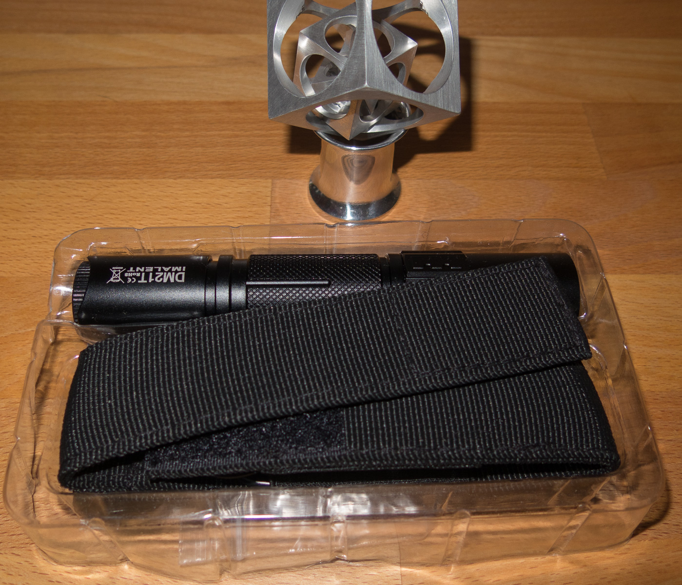

The light sits in a plastic inlay

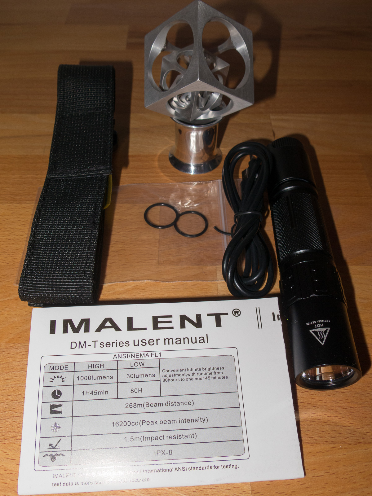

It comes with a holster, 2 spare o-rings, USB cable and manual

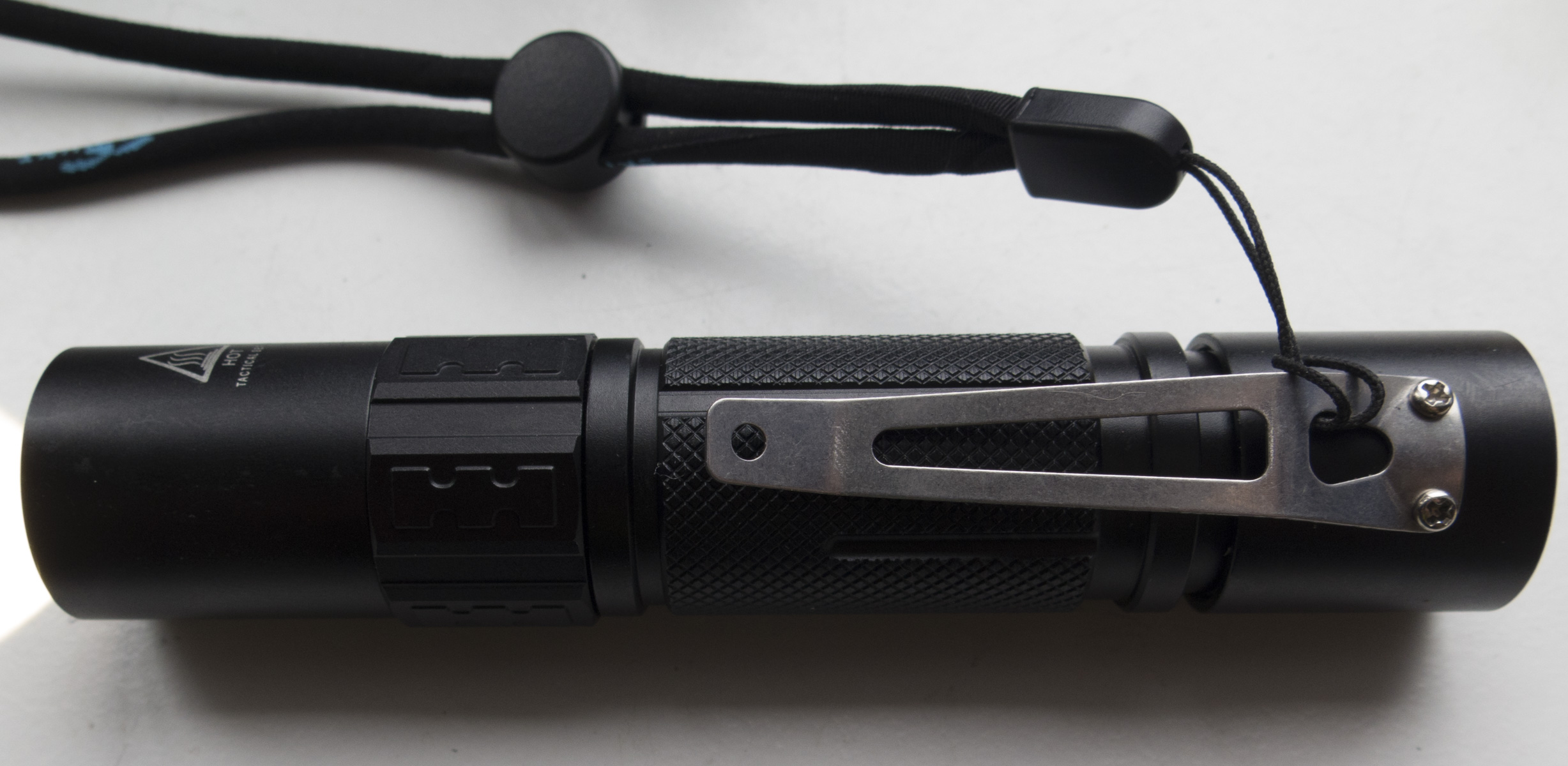

due to the rotary brightness selection there is no way to attach a lanyard

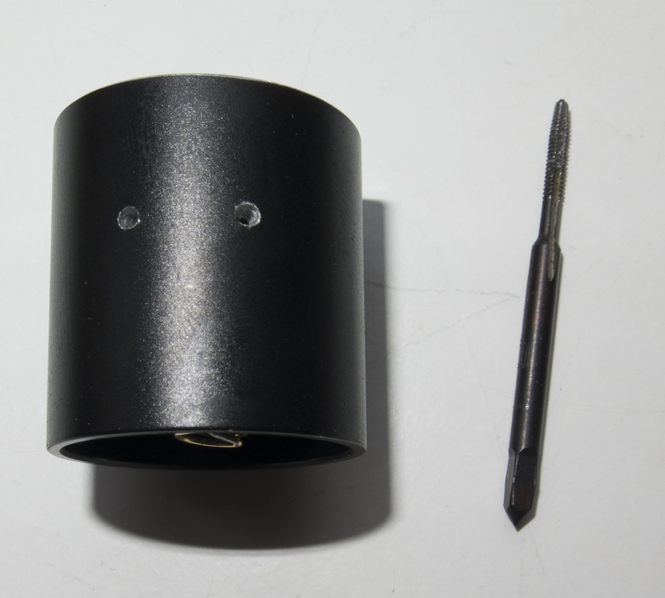

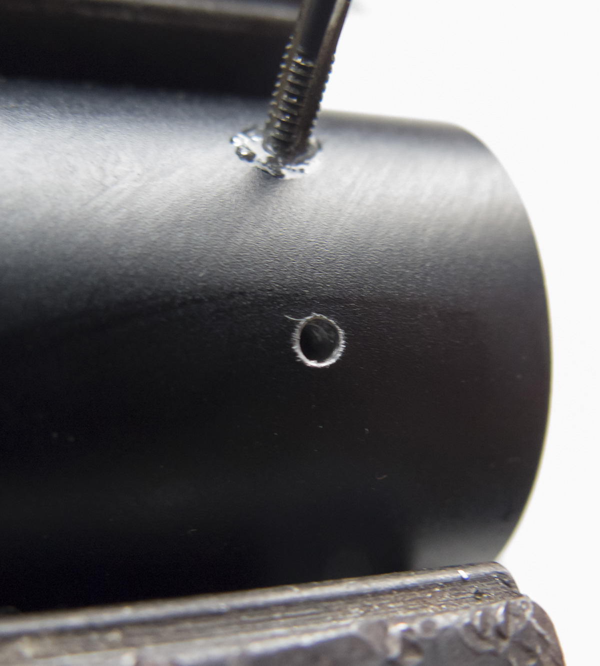

The light has 2 holes on its back maybe its possible to drive a small screw in there for a lanyard

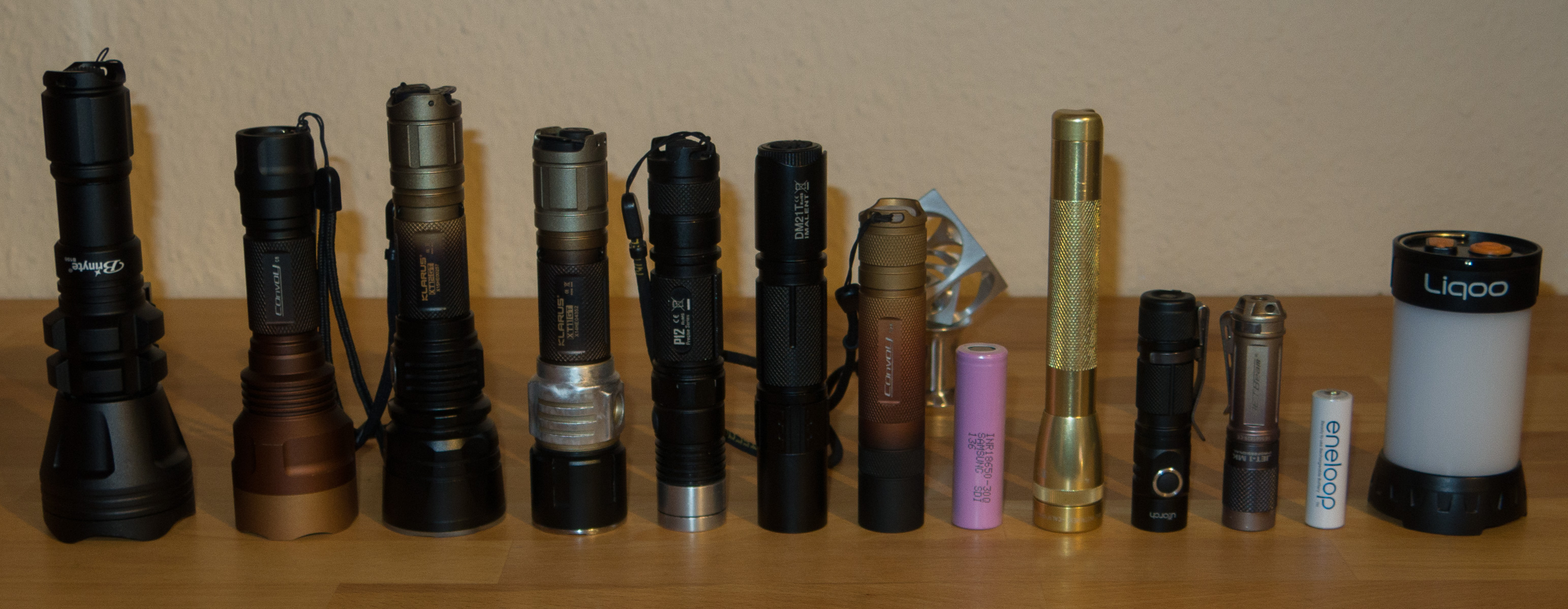

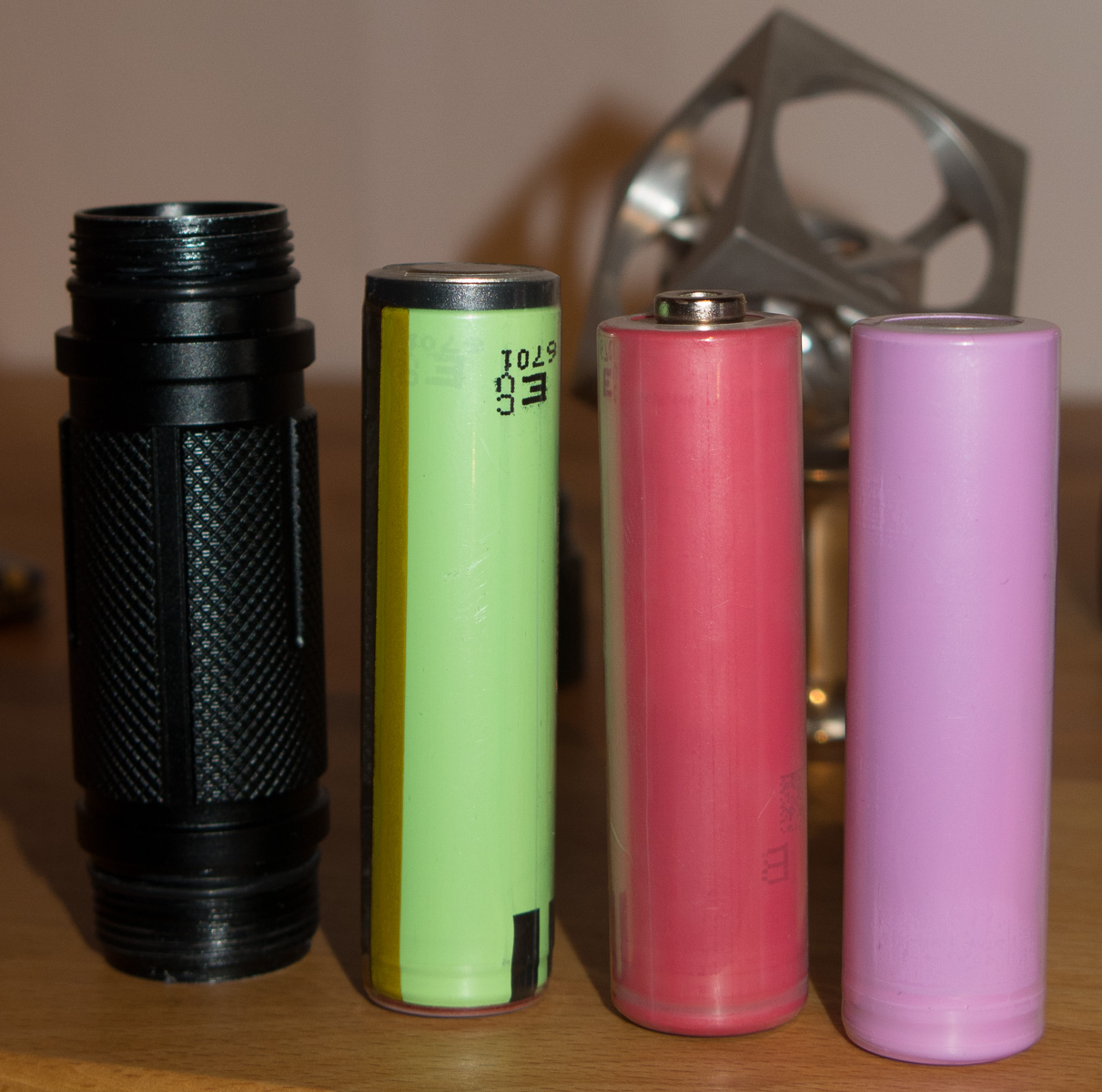

Size compared to other 18650 and AA lights

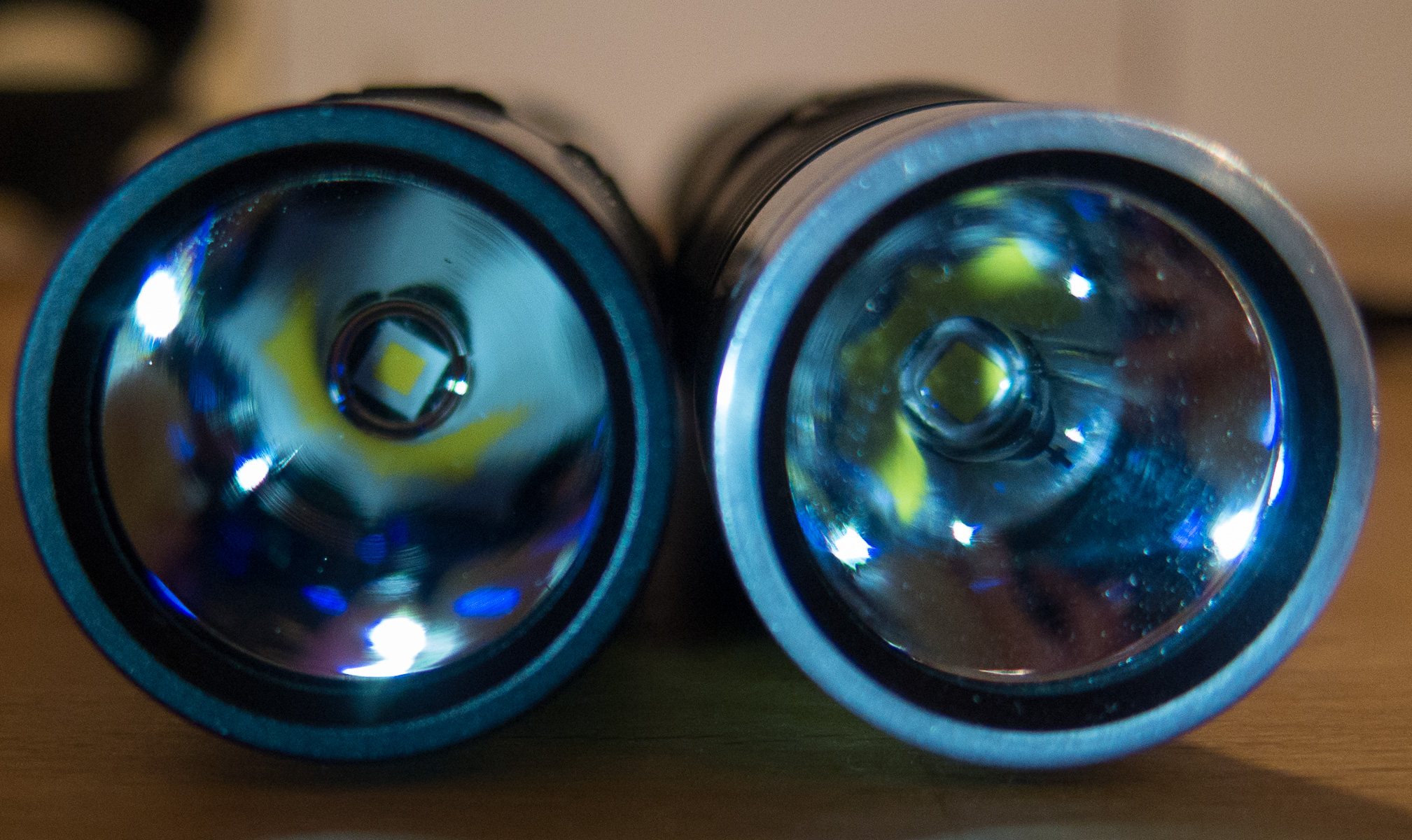

Beam color is on the warm side of neutral
from left to right the lights get warmer, picture taken @5000K camera setting
The Imalent LED is most likely a U6-5A2 at 4000K as it is warm er and the CRI is better than on the 3C tint ones

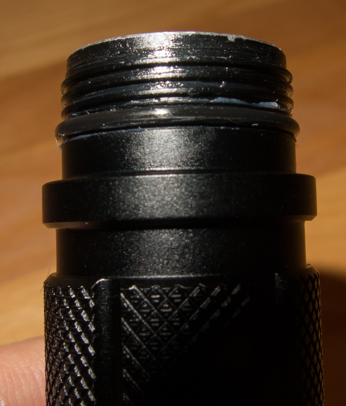

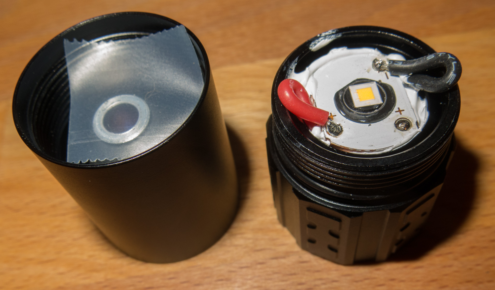

The light can be taken apart, the head is not glued

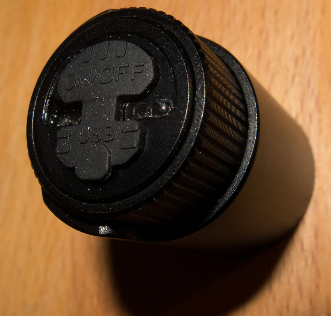

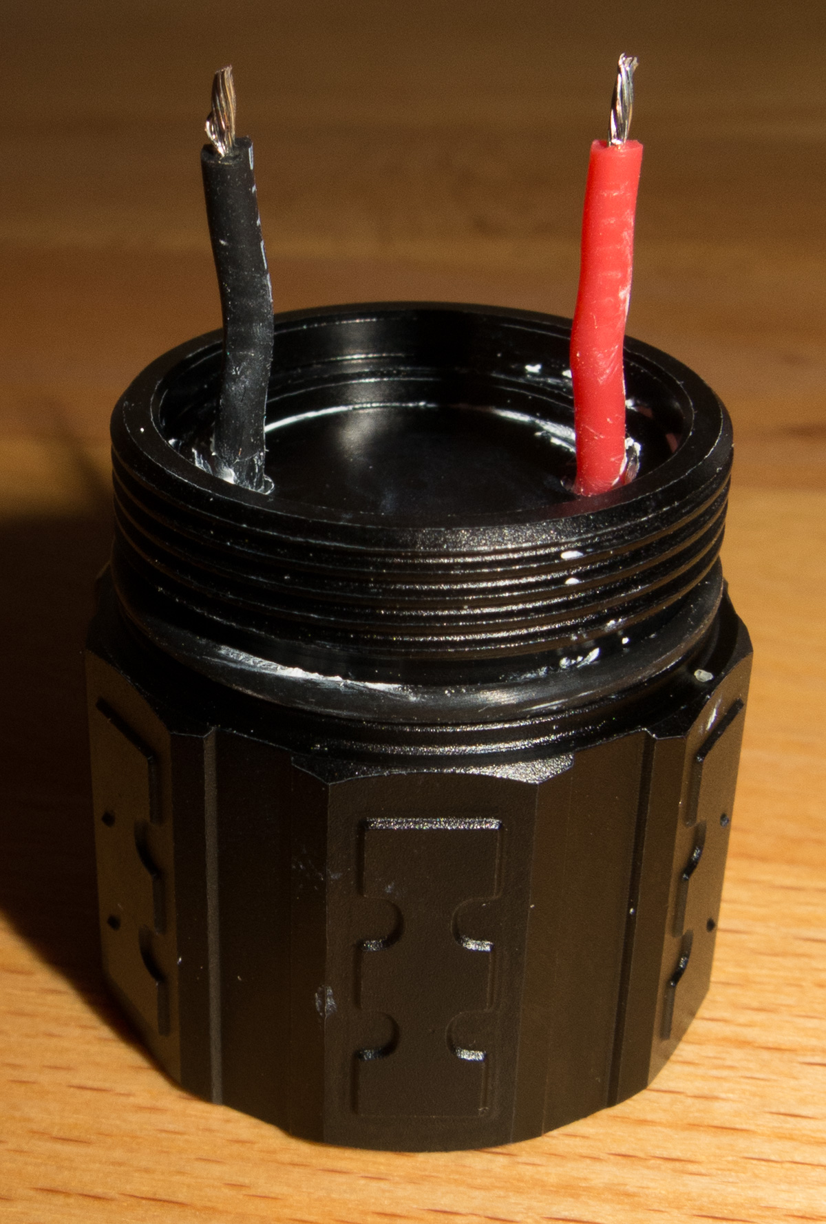

But on the tail it looks like the section with the e-switch and the USB charging port is glued with transparent silicone on the middle section, so it holds the rotary ring for brightness adjust in place
The transparent silicone also covers the holes for the status indicator LEDs
Because of the glued tail I can’t remove the driver completely because the wires are too short

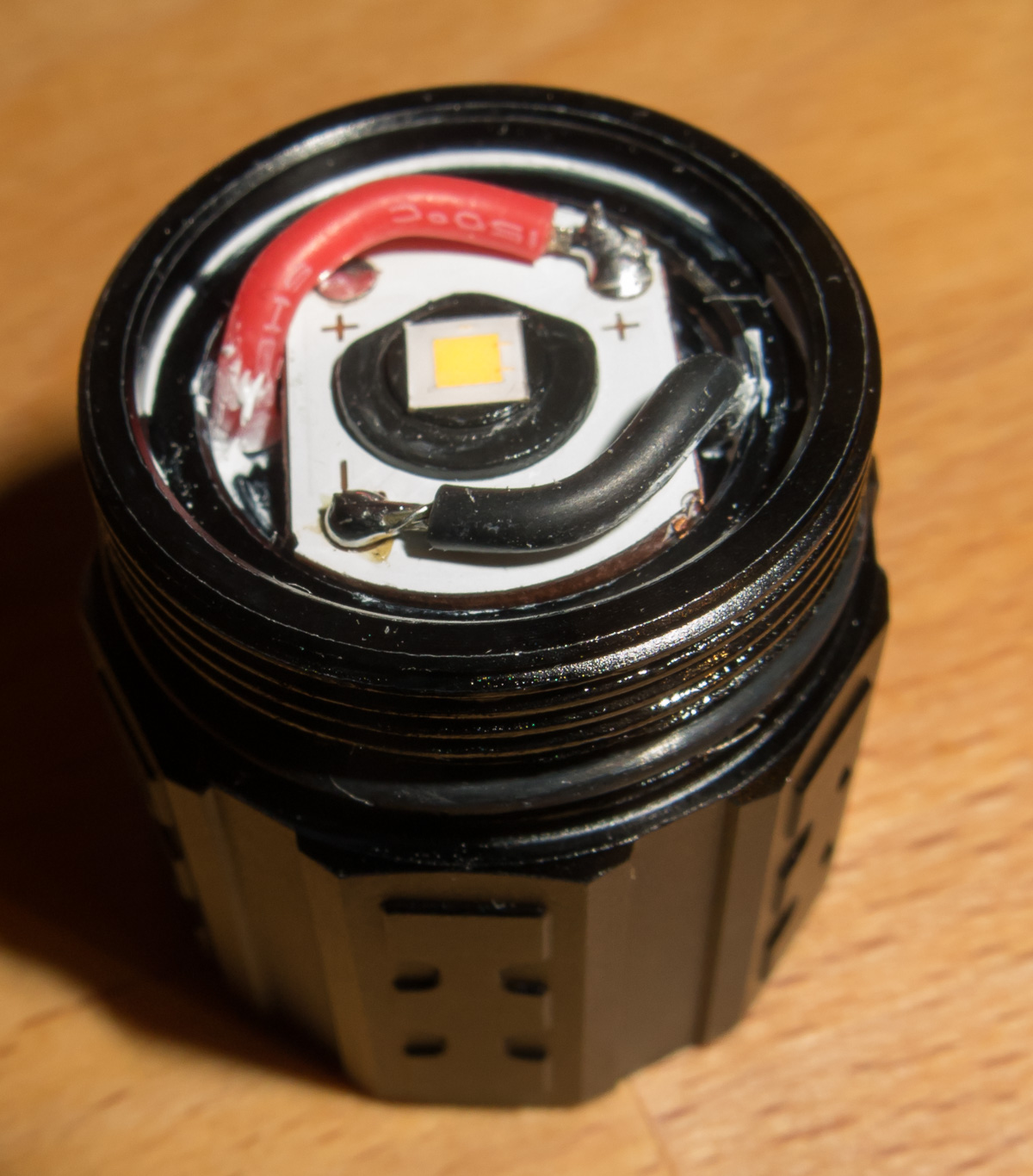

The head has no driver just a plate wired with the LED
It is press fit and I can’t get it out, but on the other side has to be some Diode or electronics to allow the head to charge from the USB port in the tail cap

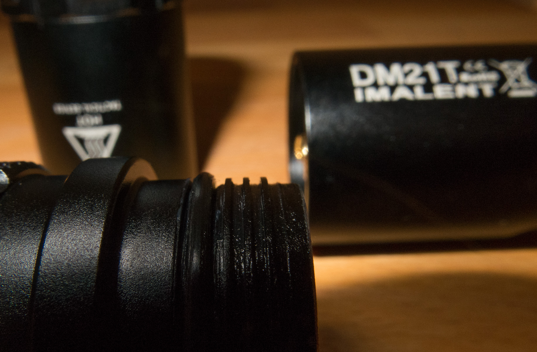

The threads are smooth and square cut, good quality
the light can be locked out by twisting the tailcap a bit

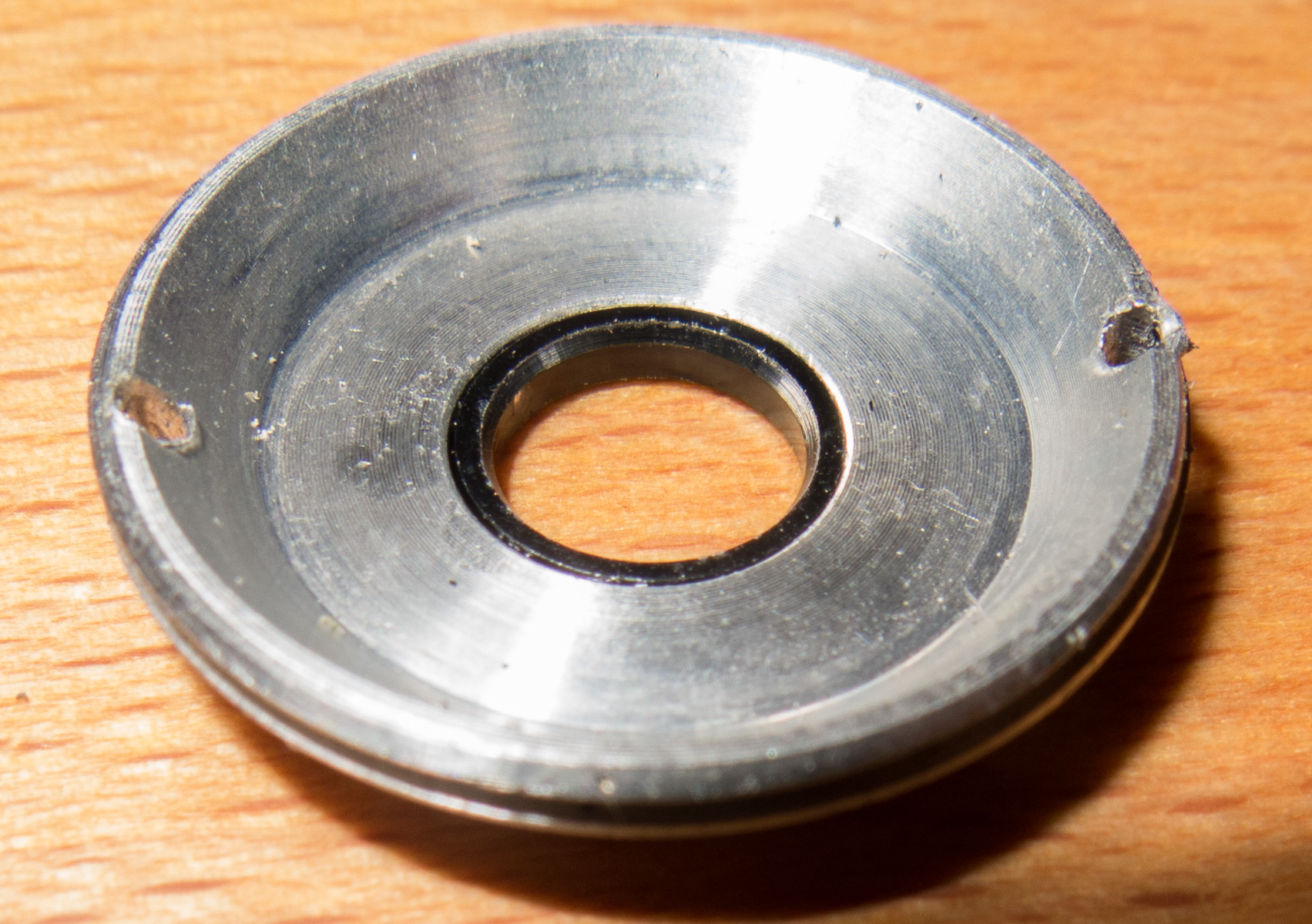

The reflector is smooth, got some imperfections but that won’t affect the beam at all
the XPL HI LED is perfectly centered
the reflector is 22.5mm wide and 18mm deep

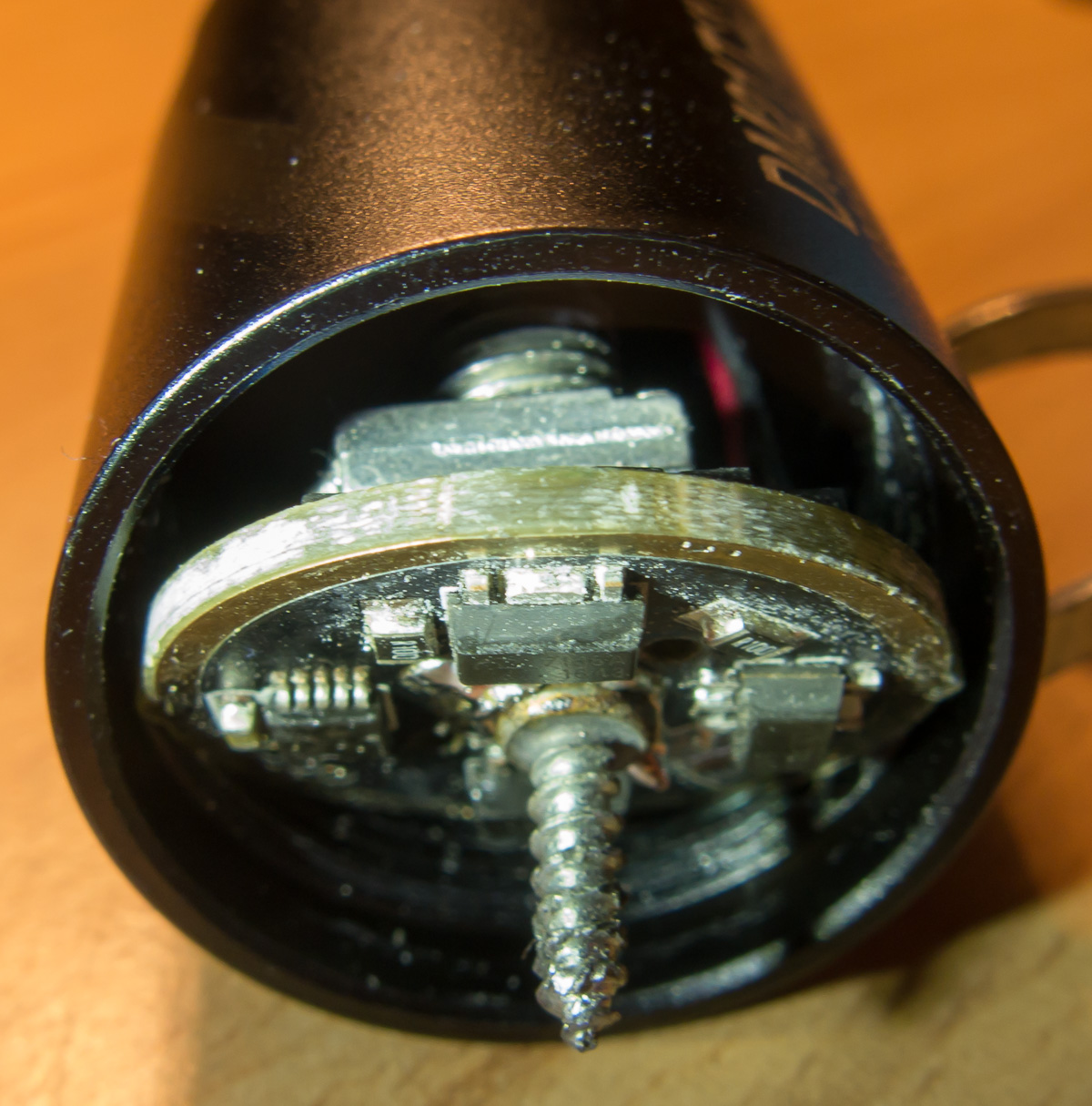

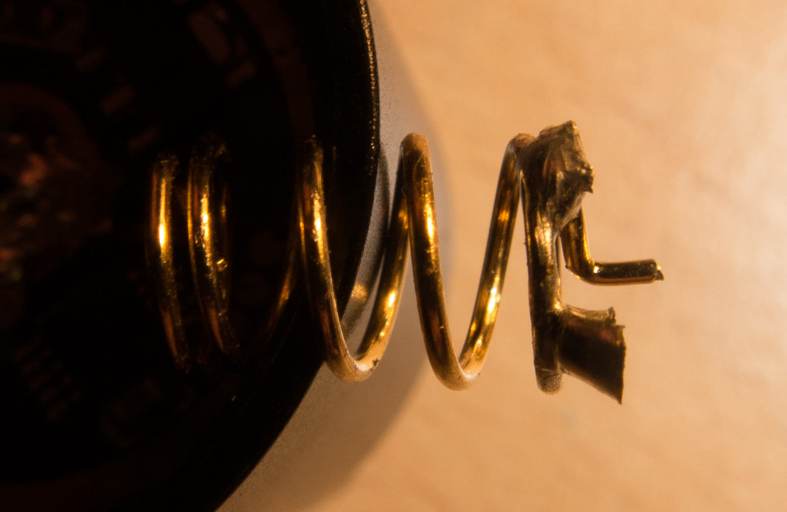

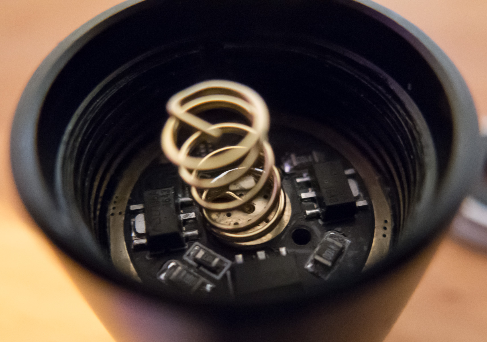

When opening the light i noticed the spring in tail cap is not soldered flat to the driver
it looks even worse after removing the driver retaining ring
I tried to pull out the driver, but the solder joint was poor and came apart
I guess this light was produced on Monday morning or Friday evening, by an unmotivated employee with too low soldering iron temperature
The spring has a centering pin what is really nice and first time I have seen this, very good
soldered a bolt on the driver to pull it carefully out, this is as far as I can go without ripping the cabled of the back as they are soldered and glued in the tail cap

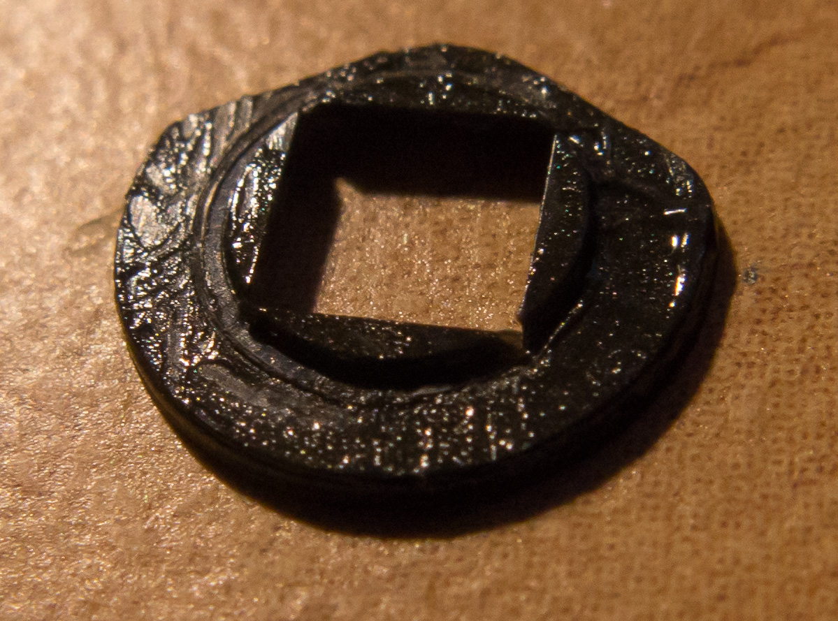

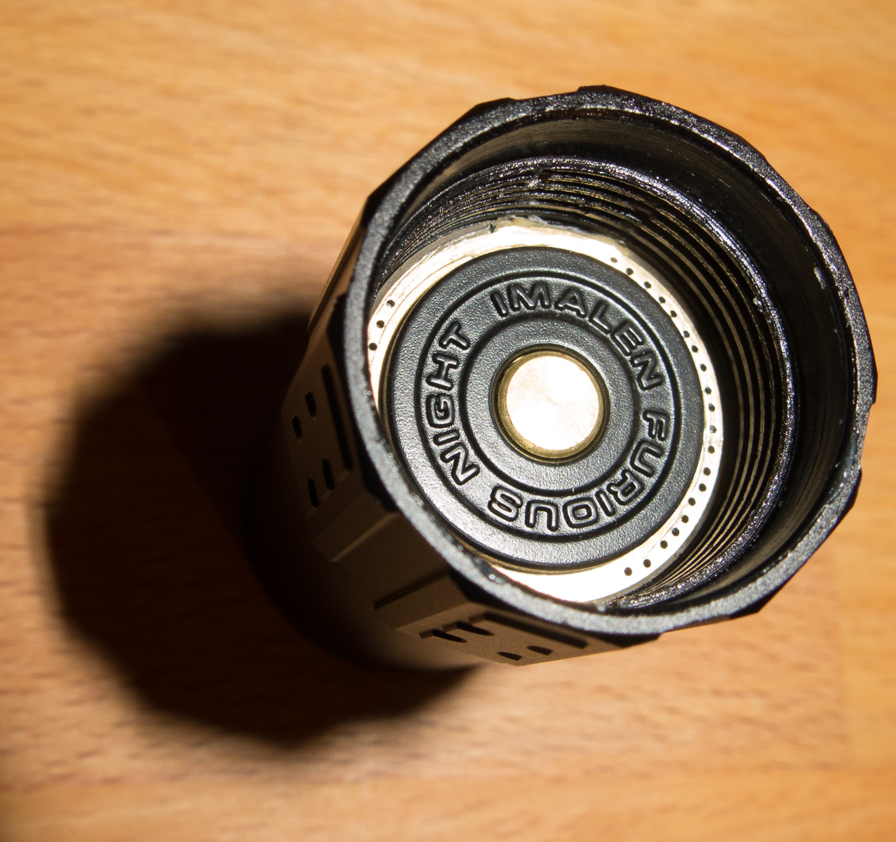

The driver retaining ring in the tail cap has a hole with a plastic insulator for the spring
The tail cap and head threads have an oring and are lubed for water tightness
The light is build for protected button top batteries, no button or too short wont fit, as the light has no LVP its better to use protected
Left the 18650B fits perfectly, middle a Sanyo 18650GA fits only with a magnet on its tail or top, right a Samsung 18650-30Q makes no contact to the spring or head

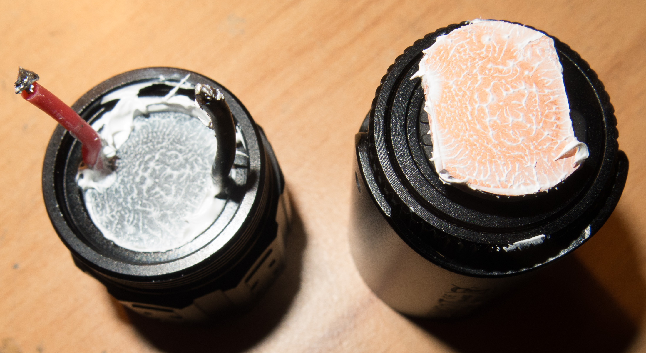

The thermal paste is applied in a big quanrity and is perdfectly spread and a very thin layer due to good machining

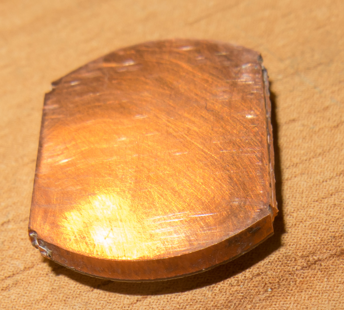

I checked the MCPCM to be a true copper DTP one, very nice
The MCPCBs back is perfectly flat I sanded it with 2500 and the whole area gets sanded

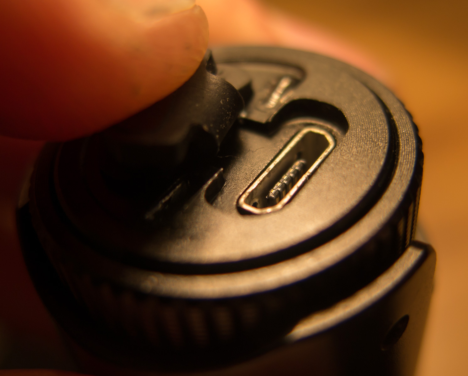

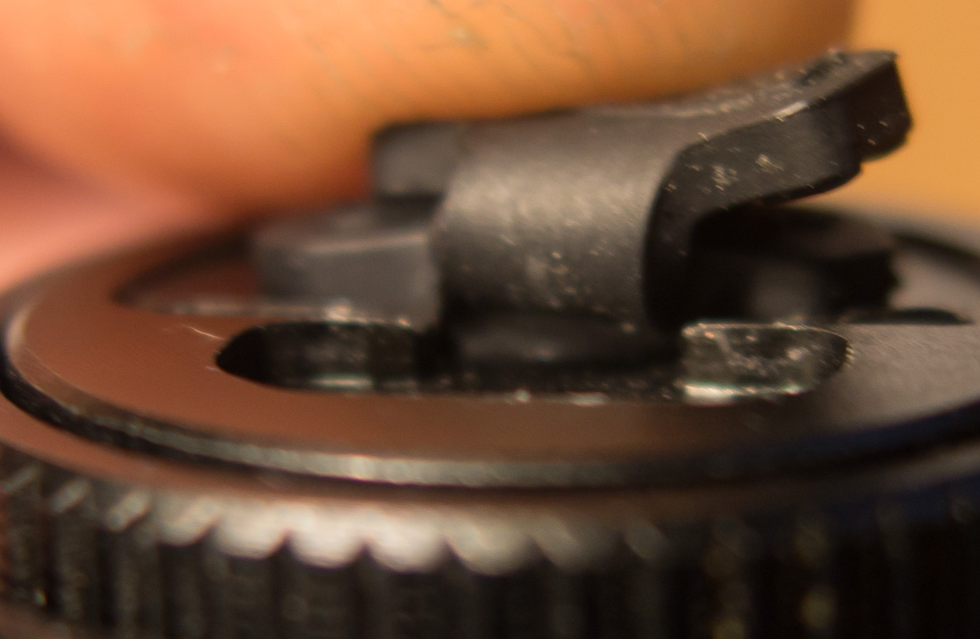

The USB charge port cover is badly designed, it won’t be IP X8 waterproof like advertised
If you look close you see the middle part of the cover which connects to the switch cover cant seal with the body at all, as it does not go to the bottom of the tail cap

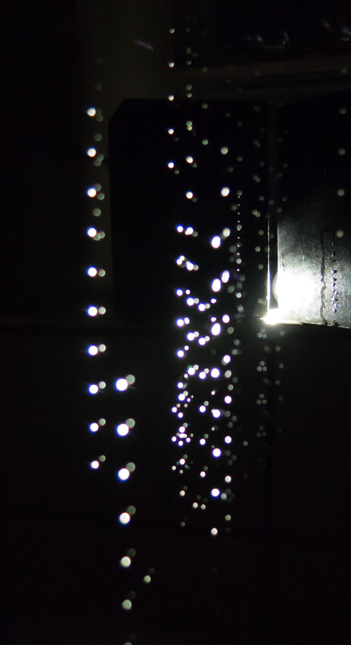

The light has a pretty slow PWM visible in all modes
the oicture taken with 1/50s 10 spots = 500Hz

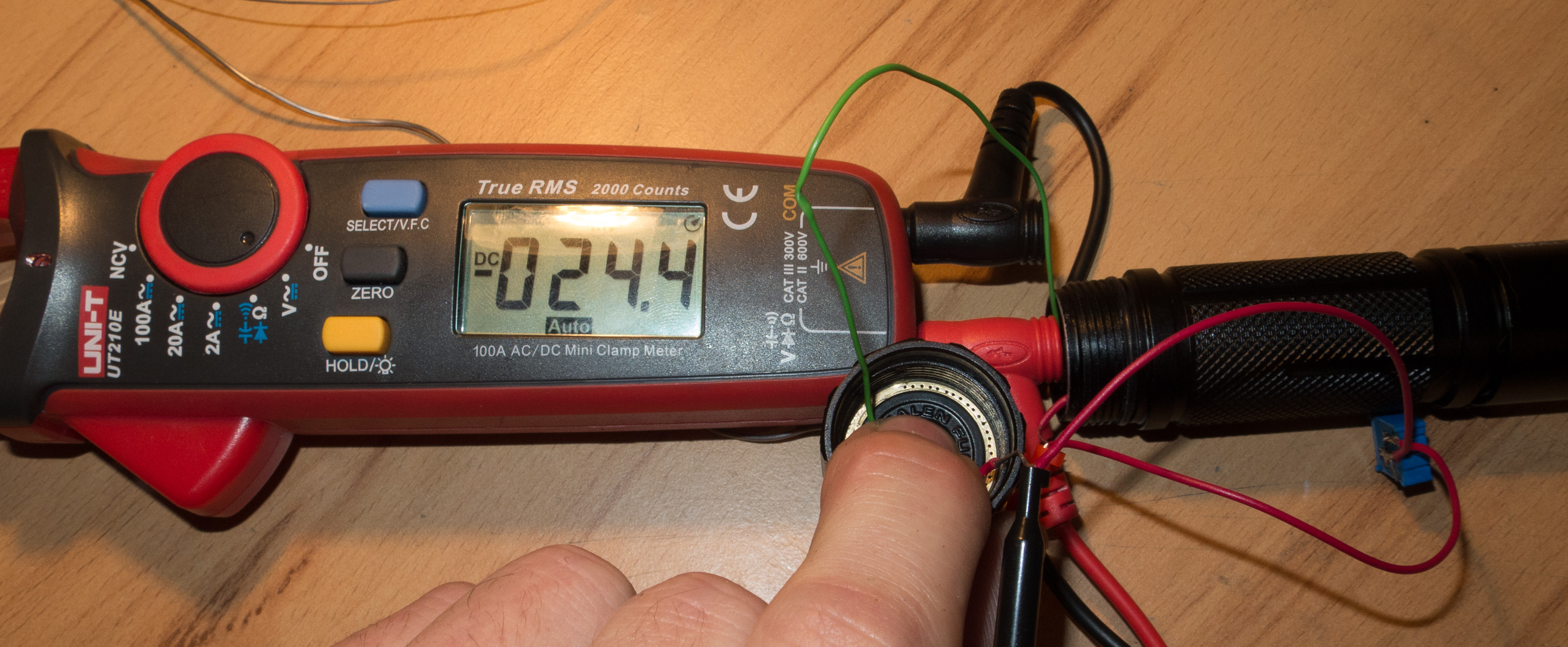

The light has a parasitic drain of 0,025mA @4.05V which is lower than the battery self discharge
I could measure 2.6A tail cap current on brightest level
couldnt take a picture as I needed both hands as the driver is in the tail cap

Cleaned the old thermal paste
Cut the wires a bit shorter
Added a bit of lubricant to the centering ring as the LED MCPCB has no screws or other secure to rotate when twisting the head to prevent the MCPCB from getting grip and rotate, which may lead to a short cutting in the wires
removed old ceramic thermal paste and added arctic silver 5

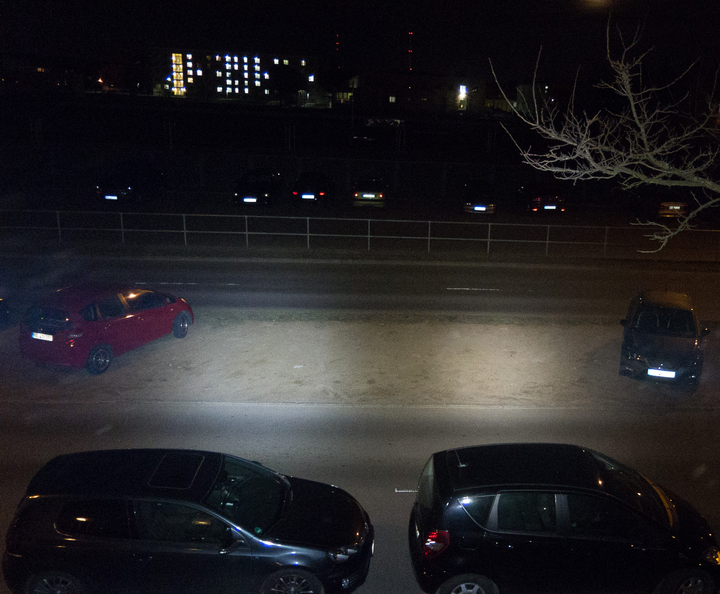

Left side Nitecore P12 @1050 lumens modded with DTP star and XML U3-3D NW LED running at 3A
vs.
Imalent DM21T with about 800 lumens running at 2.6A on the right side
Both lights are neutral white, even if the Nitecore P12 looks here cool white
Nitecore left and Imalent right, the Imalent DM21T is more neutral-warm white, not sure which color bin they use most likely U6-5A2
you can see the domeless emitter throws better with a smaller hotspot, both lights have about the same reflector size but the Imalent reflector is deeper
Klarus XT12GT XHP35 E4-3C 1.38A @1900 lumens next to Imalent DM21T
The Klarus XT12GTS outtrows the Imalent easily due to the larger head and at leasrüt twice as much lumens.

I did solder the spring in right angle and added a spring bypass
Also did the LED wires cut a bit in length and soldered them so that they prevent the MCPCP from rotating
Beam shots:
vs.

- claims IP X8 waterproof, but the design of the USB port cover is really weak and won’t be even close to be waterproof
