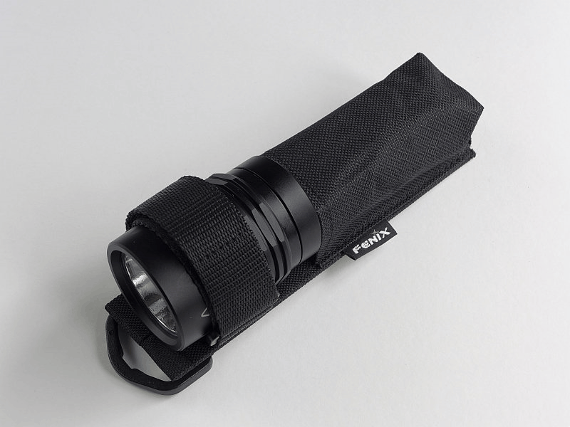

Looking around the holster, it has a hanging loop and belt loop. Unlike most holsters, there is no flap, but instead a Velcro strap that is used to secure the TK35 UE in the holster.
